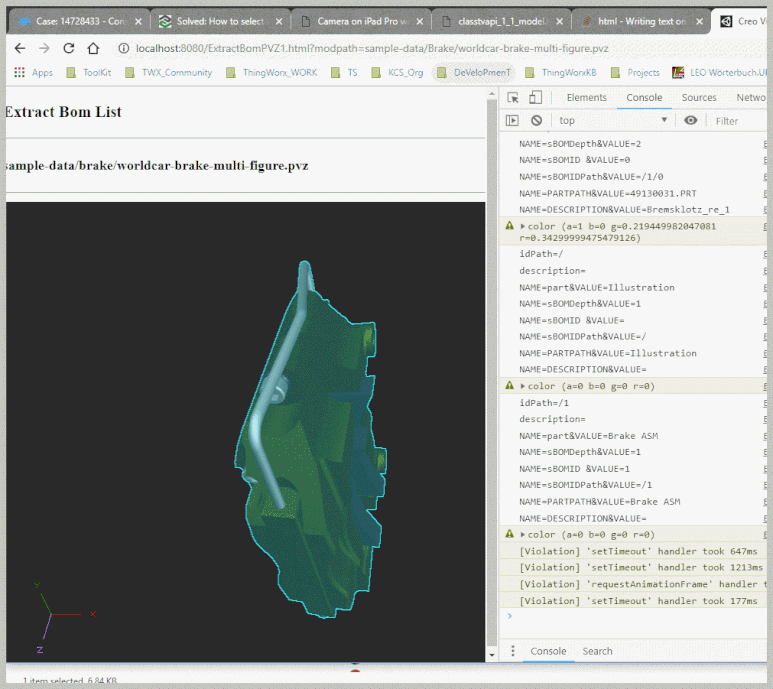

We can call the Creo View WebGl Toolkit program above in chrome with a parameter which will specify a path of the .pvz model – example:
http://localhost:8080/ExtractBomPVZ.html?modpath=sample-data/Brake/worldcar-brake-multi-figure.pvz
The program will selects all visible components and will print to the console the idPah, partname , color etc…

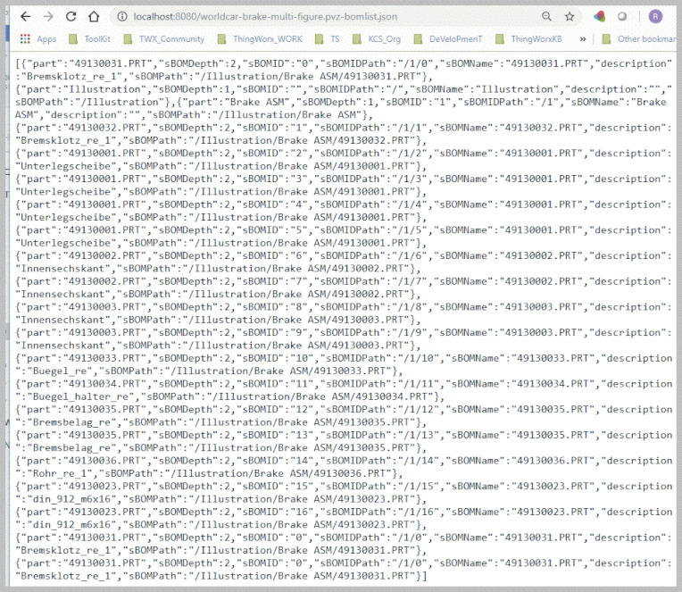

One problem we have here is that we could not print it to a local file because of the security restriction of the browser. A possible solution is to sent them back to the server e.g. as Json object and save them to the server root directory. Later we can download these file if required e.g. calling the json:
http://localhost:8080/worldcar-brake-multi-figure.pvz-bomlist.json

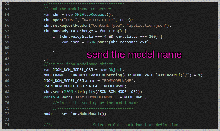

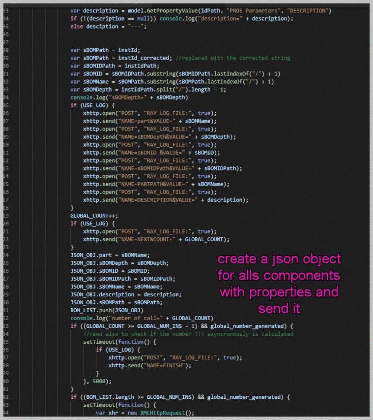

To implement json file creation we need  to change the CreoWeb.Toolkit html file to send data to the server but also we need to modify/extend the server http.createServer() callback function to handle also the received data.
Also as next we will extend  the Creo View Toolkit  program file by adding a XMLHttpRequest() will will send the modelname and the generated json object to the http server

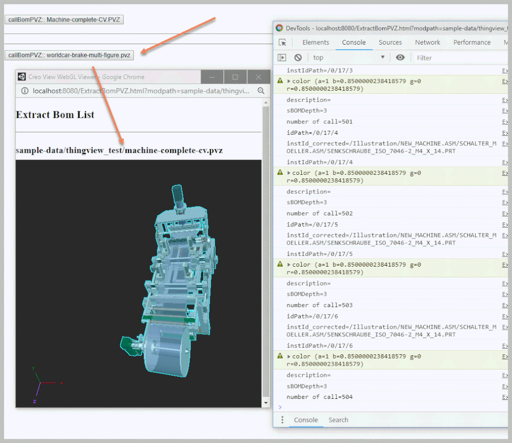

 The Toolkit html file with parameter we can also call from a javascript or other html file:

It is coming form another version named CreateBoomPVZ.html where I tried to select all instances and then used this variable to track the number of the selected instances something like this:
           ////==================LoadFromURL Callback
            model.LoadFromURLWithCallback(CUR_MODELPATH, true, true, false, function(success, isStructure, errorStack) {
                console.log("Model(2) LoadFromURLWithCallback - success: " + success + ", isStructure: " + isStructure);
                if (success) {
                    session.SelectAllInstances()
                    var num = session.GetSelectionCount()
                    console.log("Number of selections =" + num)
                    GLOBAL_NUM_INS = num;
                    global_number_generated = true;
                    if (USE_LOG) {
                        xhttp.open("POST", "RAY_LOG_FILE:", true);
                        xhttp.send("NAME=NEXT&NUMINST=" + GLOBAL_NUM_INS);
                    //model.ShowAllModelAnnotations()
            ///model load from URL funciton
