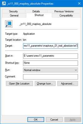

if you disable unwanted functionality by browsing to the General Setting dialog then this action is recorded into trail file (I hope).
Later you can use this trail (little bit modified) when you start Creo.
For example ... in my case Target field contains
"E:\PTC\Creo11_000\Creo 11.0.0.0\Parametric\bin\parametric.exe" "E:\users\creo11_parametric\mapkeys_01_trail_absolute.txt"

Appreciate the information Martin!  I'll ponder this approach.
