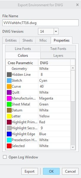

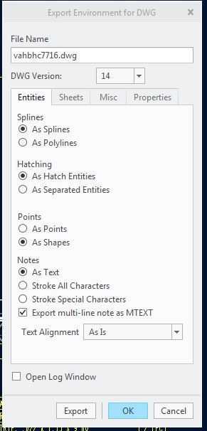

Attached is the syscol file that we are using. The dxf_eport file. We are also exporting to dwg version 14.
Dale_Rosema
(To:Dale_Rosema)
I cannot get the syscol.scl file to attach - I get an error message.
I also tried "white" instead of "7" to no avail.
Here are the two export windows:
Creo 5 does not have the UNICODE encoding. Does that make a difference?

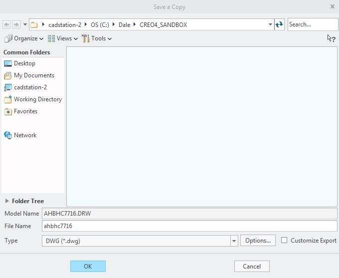

There are (2) different ways of creating a .dwg file and I was trying to figure out if they were paths to the same output.
1. File-SaveAs-Save A Copy (select dwg for file type)
2. File-SaveAs-Export (select dwg)
If you click on Setting when exporting it pops up the same window when you do Save A Copy - the 4th tab is properties - here is where I need it to change everything to white. Can it read in a file to do this?
I tested and if I click on everyone and change to white the viewer will show a DWG with a white background and black text.
Thanks, Dale

As for the def_profile.dep_dwg, it comes from:
Save As: (then selecting DWG for the type)
Then clicking on the Options... box after DWG: (DWG Export Profile Setting)
Then click on Load Profile... box (to get the file name it is looking for def_profile.dpe_dwg)
That is why I was asking about that file name.
