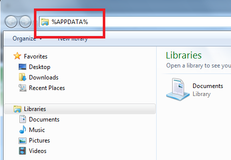

1.] launch Windows Explorer
2.] enter %APPDATA% in its address field
3.] press Enter
4.] rename PTC sub-directory in C:\Users\YourUsername\AppData\Roaming directory
5.] launch Creo 3.0

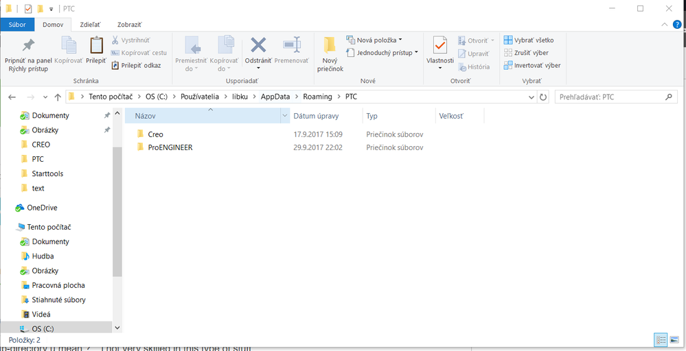

Martin Hanák
what sub-directory u mean ? .. i not very skilled in this type of stuff
and what should i rename ?
What sub-directory should i rename ?
Taday i tried to completly reinstall CREo plus i deleted the PTC folder from %APPDATA% ... but when i used school starttools same thing happened, creo works for 1 sec and than crashed
