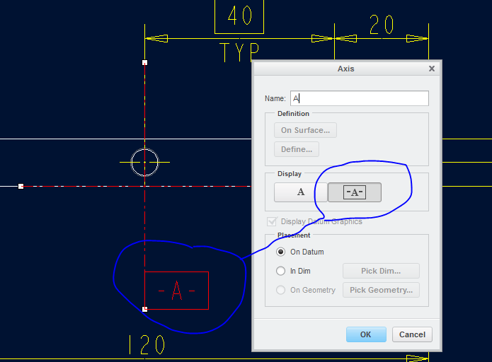

Hi All,

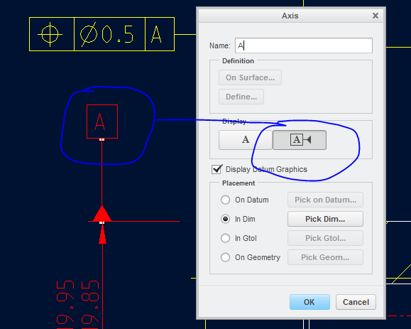

How do I change the style of the datum axis display in a drawing? I want to change from:
to:
I'm guessing its somewhere in the config however having played around with a number of settings i am still yet to achieve what I want.
Joe

I believe in your .dtl, set the following
new_iso_set_datums YES
then this is self explanitory
set_datum_triangle_display FILLED
then perhaps, because I have not found the difference
gtol_datums STD_ASME
you can try them at FILE > Prepare > drawing properties > detail options (select change) then add/change the options as needed
