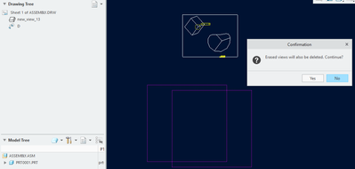

A detail view cannot have any of the names A, B, or C. When trying to delete the sheet, I get a message "Erased views will also be renamed." How to delete those views without deleting the sheet?

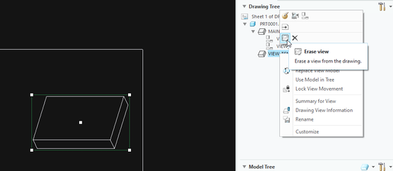

Are you able to look at the drawing tree? You can select views to erase and resume from there by picking the view. In my test, I can see the view if it's erased or resumed. I can delete it in either state as well. When a view is erased it appears as a hidden item in the drawing tree. I opened your example but didn't see any erased views on either sheet. Maybe I'm missing something?
The erased views are not in the Drawing Tree.
The detail D cannon be renamed either A, B, or C. This happened because there are erased and not deleted views with those names.
Their contour can be seen if I try to delete the sheet. But I cannot select them otherwise.
Please take a look at this article. I've run into the issue described in the past. Using the config option fix_draw_partial_del_bug fixed the issue.
https://www.ptc.com/en/support/article/CS38939
Thank you very much for your help. That solved my problem.
