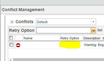

ganeshkela
(To:TomU)
For me, it didn't  work.
Issue is - no retry options found in conflicts, as attached below,.
TomU
(To:ganeshkela)
Certain types of errors don't offer a retry option because retrying won't fix the problem.  What kind of error message are you seeing?

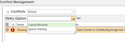

ganeshkela
(To:TomU)
Agree but for the same operation (revise), I can see the retry option in standalone windchill workspace, see below.
What I noticed is in Creo its only "View conflict" whereas from Windchill its "Overridable conflict", I wanted to know why this difference for same set of objects + same action.
Do you have any information/hints on this ?
Thanks.
BR,
Ganesh
