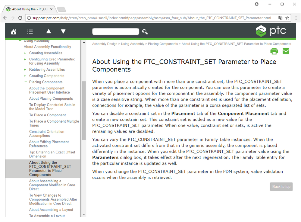

in assembly you can define several constraint sets for specific component (only one of them is enabled). Creo creates special parameter named PTC_CONSTRAINT_SET for this component. In assembly you can create family table and add this component parameter into it. Then you can set parameter value differently for different instances.
See
http://support.ptc.com/help/creo/creo_pma/usascii/#page/assembly%2Fasm%2Fasm_four_sub%2FAbout_the_PTC_CONSTRAINT_SET_Parameter.html

But a quick search for "PTC_CONSTRAINT_SET" in the Creo Help Center show this:
http://support.ptc.com/help/creo/creo_pma/usascii/index.html#page/assembly/asm/asm_four_sub/About_the_PTC_CONSTRAINT_SET_Parameter.html
EDIT: Some how, the link gets modifed by the forum software. Strip everything after "About_the_PTC_CONSTRAINT_SET_Parameter.html" and the page should open.
