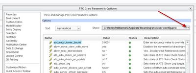

StephenW
(To:RWL)
Possibly you have multiple config.pro files loading or you have the option specified in the config.sup which would not allow you to change the option at all.
You can see what config files are loading by looking in FILE - OPTIONS - CONFIGURATION EDITOR and pushing the drop down arrow shown in the image below.
RWL
(To:StephenW)
I have checked the config.pro file to confirme that "display_axes" is still set to no, and it is.
I went into the conguration editor, and see that is is still set to yes there.
Again, I have no other config.pro files other that the one in the PTC folder and "display_axis" is set to no there as well.
I have no config.sup file, or at least not that I can find. Where would it be located?
