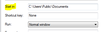

1. short cut for modelcheck.bat
2. Modify the Start in folder to where parts are located
3. In the Start in folder, a config.pro has MODELCHECK_ENABLED set to YES
4. Run modelcheck.bat, select the .lst file (created in cmd) and parametric.bat
