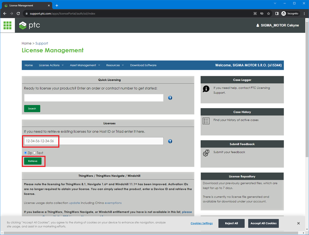

2-3) As you know every Creo subscription may be used at home as well so you can generate license for home use (private MAC address).
After I generate home license via "PTC/Manage License" then using a button "Retrieve license" so file "license.zip" is generated and sent to my email but it fails (even popup says it has been sent OK).

I use following procedure:
Martin Hanák
The procedure works well in case that you installed HomeUse license to specific HOST-ID in the past.

option no.1
option no.2
  • create new PTC account using different email address (in Czech Republic you can create email at seznam.cz for free)
  • login using new PTC account
  • retrieve HomeUse license
my test
  • I retrieved HomeUse license a couple of minutes ago using seznam.cz email adress
  • it took 5 minutes for the email with the license to arrive
Martin Hanák
You can also open Case at PTC Support and ask them to send you HomeUse license file. Some person from PTC Romania will solve your request.

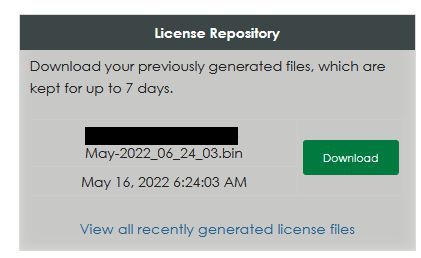

Anyway I see very useful tools called "License repository" aside email but this is not available atm for standard licenses (ThingWorx only).
PTC should allow it and problem with sending emails will be solved...
