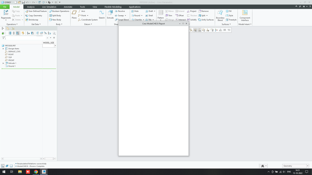

I am using Creo Parametric Release 9.0 and Datecode9.0.0.0
About Model Check
My model check report is coming up blank.
I only use it for overall size of part.
Hi @harshad_iCAD,
This may happen due to write access to generate the reports. You may create a new folder (may be in C:\temp) and set that as the value of DIR_REPORT in config_init.mc.
Image for reference .

Hi @harshad_iCAD,
https://www.ptc.com/en/support/article/cs375984
I hope this will help.
