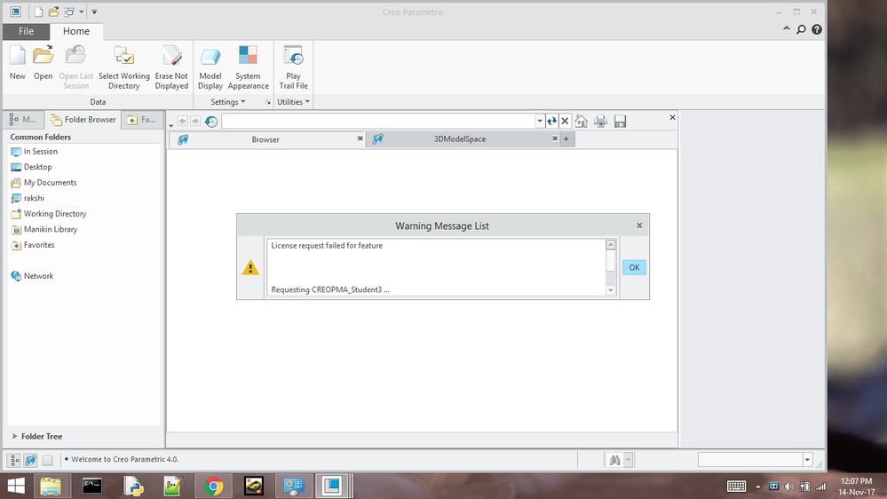

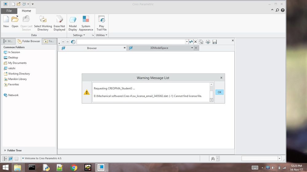

i have inserted creo 4 student edition license only,software was working correctly after installing it,then for 2nd time when i launch the software i am getting this error...

so its simple ... Creo cannot start because it cannot find licence file
I do not know where did you save license file. Can you locate it on you disk or in your emails?
Martin Hanák
i save the file in E drive and it is in my email also
so recreate file license_file.png from your email and start Creo.
Martin Hanák
if license_file.png exists, then I guess spaces in folder names can cause the problem.
Replace spaces with underscores and modify path to license file in parametric.psf file located in CREO_LOADPOINT\Parametric\bin directory.
Martin Hanák
now software is not asking license as i reconfigure it..thank younow software is not asking license as i reconfigure it..thank you
