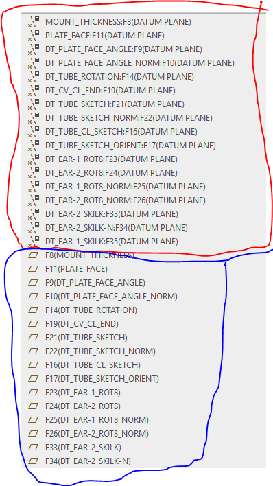

See image example below:
The red can be added to the shown layer but will not display if it is on another layer that is hidden.
The blue can be added to the shown layer and shown but if the blue item is related to a red item on a hidden layer it will not be shown either.

Based on the icons, I believe that the items in red are feature entities, the items in blue are features. So red item #1 is the MOUNT_THICKNESS datum plane itself, blue item #1 is the MOUNT_THICKNESS feature. It's easier to understand with other features like a sketch. A sketch feature will contain multiple sketch entities (lines, arcs, etc.) and a datum plane feature contains a datum plane entity.
If a feature is on a layer and hidden, there's no way to make individual entities of that feature shown.  That's why adding the datum plane entity to the shown items layer won't make it appear if the feature is hidden.
If the datum plane feature is placed on the shown items layer but the plane entity is hidden, it'll be hidden.
I find it best to only put features on layers, not entities, because of this rule.
