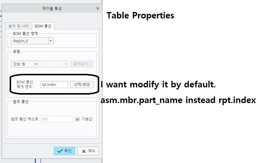

when I make the BOM baloon. I want to change the default value rpt.index to the other one in table properties.
anyway I want to show you the picture.
@Yunny(Yunko_KR) wrote:
I can modify that click the select and change... if I can, I want to know set it by default value..
Anyway thank you for interest of my question.
1.]
You cannot set asm.mbr.part_name as default value used for creation of any new repeat region.
2.]
You can create repeat region, set asm.mbr.part_name as BOM value, save table into .tbl file and import this file into new drawing when you need it.
3.]
You can create drawing format -OR- drawing template, place the needed repeat region table into it and use this format/template when new drawing is created.
