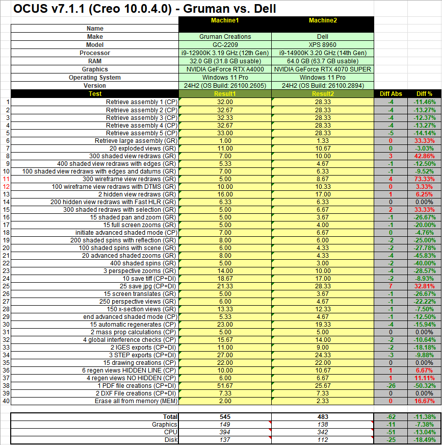

I just got done running an OCUS benchmark v7.1.1 with Creo 10.0.4.0 on a new Dell XPS 8960 and was presently surprised by the results. Results show an 11% speed improvement compared to our current Gruman Creations 2209 machines.
