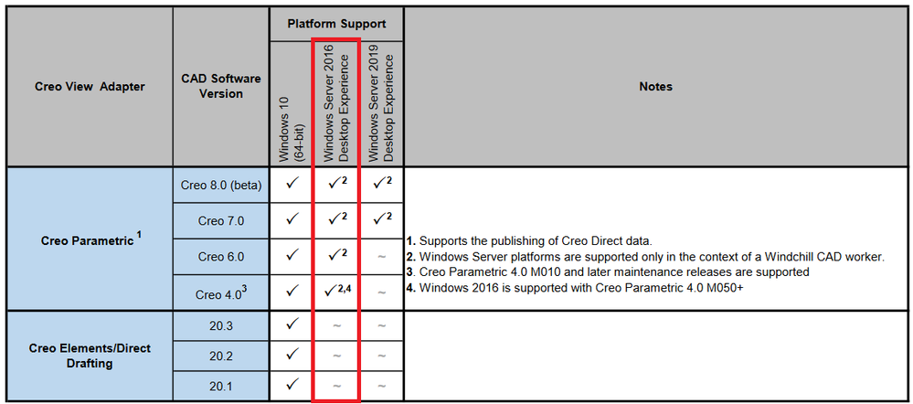

Hi, i have a Creo Design Esential License, and i want to install on a windows 2016 Datacenter, it's possible?
Does it only have to be installed on computers Windows 10 64-bit Editions: Windows 10, Pro and Enterprise (1)
Windows 8.1 64-bit Editions: Windows 8.1, Pro and Enterprise (2) ???as indicated on your website: https://www.ptc.com/en/products/creo/elements-direct/modeling-express/system-requirements
Thank u.
1 REPLY 1
TomU
(To:M_Roca)
Yes, it will install and run, but it's not 'officially supported' unless it is being used for publishing as a CAD worker connected to Windchill.
https://www.ptc.com/support/-/media/support/refdocs/Creo_View_Adapters/9,-d-,0/CreoViewAdaptersSoftwareMatrix.pdf?sc_lang=en
