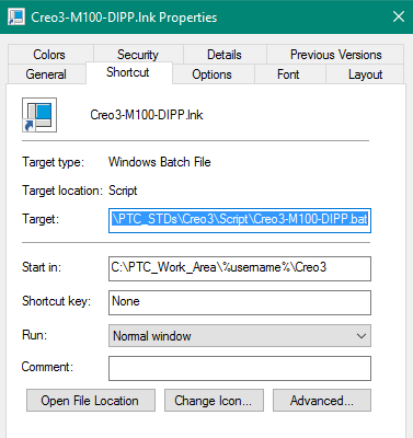

We launch creo3 by a .bat file which is a shortcut from the desktop.   This .bat file is very important because it does many things such as checks for latest version of creo, copies over latest config files, etc, etc.
Below is the screenshot of the .lnk shortcut to launch the .bat file which at the end of .bat file it executes parametric.exe from Parametric\bin sub-directory

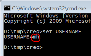

Problem is in Shortcut properties. Maybe Run this program as an administrator option is checked on Compatibility tab. To see current username in Creo session, launch Open System Window command from Creo (i.e. Dos prompt) and enter set USERNAME command.

By launching the .bat file as administrator does not help.  The advanced properties setting on the shortcut has Run as admistrator clicked as well.  If I set USERNAME in command prompt, it shows me as username.
I am the person that modifies the .bat file and distributes to all our users , I cannot figure which command that would disconnect the network drives.  Again, all is fine in windows 7.  Just does not work in windows 10.
I did not ask you to launch bat file as administrator. I wanted to tell you that Run this program as an administrator option on Compatibility tab should be "not checked" (cleared). So uncheck the option and test Creo.
I can see this username on my PC.

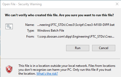

whoops, I thought you wanted me to make sure to run as administrator.  Ok, so I unclicked run as administrator, it comes up with below security warning.
Good news, that way of launching the .bat works, I now can see the shared drives.
Is there anyway to prevent the Security Warning appearing when launching our .bat file on windows 10 ?
