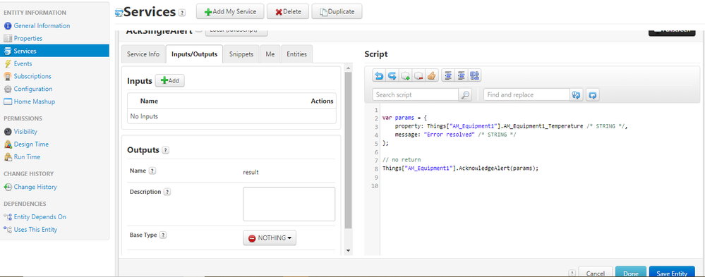

I am trying to acknowledge an alert with property using AcknowledgeAlert service but the result shows error. But when I try with AcknowledgeAllAlerts it works fine. How can I acknowledge a specific peropert alert?

For the Property parameter, you just need the name of the Property, since the Acknowledge service is already being executed in the context of the Thing itself.
So you don't need Things[ThingName]. just the PropertyName is needed in the parameter block setup.
