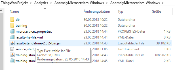

drieder
(To:BryanK)
thank you for your suggestions but that didn't work for me unfortunately. It is realy strange that the folder can't be created since the db and the training folders were created by the jars the first time I ran them.
Also I have no idea what else you have to take into account when executing these jars. The ports I setted are free and I configured the AlertProcessingSubsystem properly.
