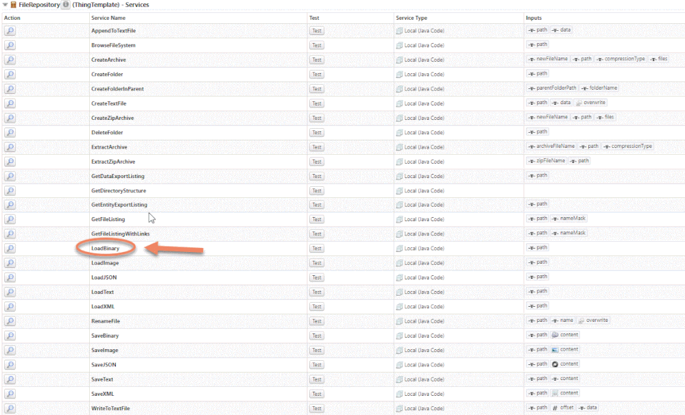

Hi @drieder ,
regarding point 2.) in your question.  The article mention by   (In ThingWorx, I have found this article about the File Repository Thing with json file :https://www.ptc.com/en/support/article/CS232916 ) is related and provides a solution for the particular case if you have some json's file. But when you need to consider the general case of any association of any files to a Thingworx object and using later these files in Vuforia Studio we need to do some further considerations.
1.) you can use Thingworx repository to attach data in Thingworx. A thing repository is a Thing which uses the  'FileRepository' Thing template. In this case you will have some services to create or list folders and  to load, download and to list files . How to handle better the data in FileRepository things -you can check the post "Upload & Download File"  and the documentation about the File Upload widget /TWX. So this could be helpful to load data to Repository and to list the current directories and files.
But in Studio you can use directly only the methods provided by the FileRepository template / inherited to your Thing/
One good candidate for usage is the service LoadBinary for the general case when you want to load files from FileRepository to Vuforia Studio. So there is example demonstrating the  usage of the method LoadBynary in the topic "Video widget in iOS" . The last post in the topic I provided example how to read a movie file via LoadBynary service and to set to property  and play with the Video widget.
In generally we need to pay attention that we can only receive the whole data to memory / in variable/ and set it to an appropriate widget property for display (could be source of image, video etc.). If we want modify this data - in this case we do not have the possibility to save it locally! so if we want to save some data to a file we need to use again the FileRepository thing  - in this case the service  SaveBinary.
So, the LoadBinary and SaveBinary are the service we can use for all possible files. For some special file like a json or Text, or Image formats we can use the specific methods LoadImage,LoadText, LoadJson, LoadXML etc.)

Sep 19, 2019 10:23 AM UTC
Hi @drieder ,
