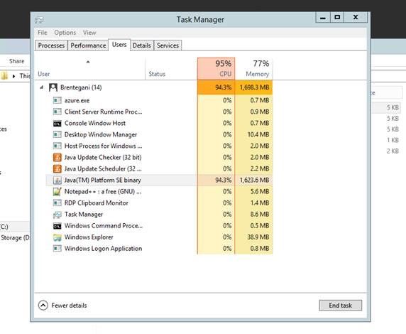

When I started the thingwox connector (which was always good for an abundant year), thousands of threads were opened constantly and grew.
This caused the saturation of RAM and CPU memory:
and when I tried to send C2D messages or read D2C message in thingworx log it was as follows:
    Wrapped java.util.concurrent.TimeoutException: Timed out APIRequestMessage [requestId: 179343, endpointId: -1, sessionId: -1, method: POST, entityName: AzureIot-cxserver-f7f78e8f-7ed1-4ee5-be25-3e13b7498724, characteristic: Services, target: AzureIotSendMessage] Cause: Timed out APIRequestMessage [requestId: 179343, endpointId: -1, sessionId: -1, method: POST, entityName: AzureIot-cxserver-f7f78e8f-7ed1-4ee5-be25-3e13b7498724, characteristic: Services, target: AzureIotSendMessage]
The connector became unusable after a reboot.

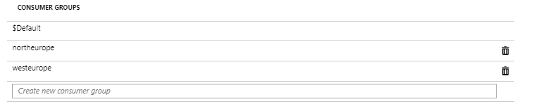

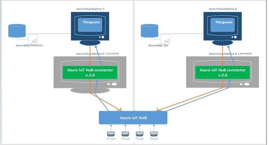

The architecture used until now is as follows:
On iot hub there are two different consumer groups for each connector:
Support PTC thanks to 'Mainente, Stephane' after talking to and investigating with the connector developer advised me to do the following things:

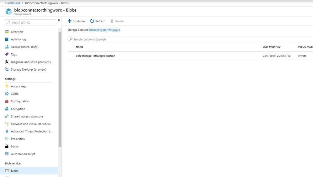

The connector uses an Azure storage account.
1) At the suggestion of Stephane I deleted all the blobs created by the connector:
2) He sent me some lines to add in the connector configuration:

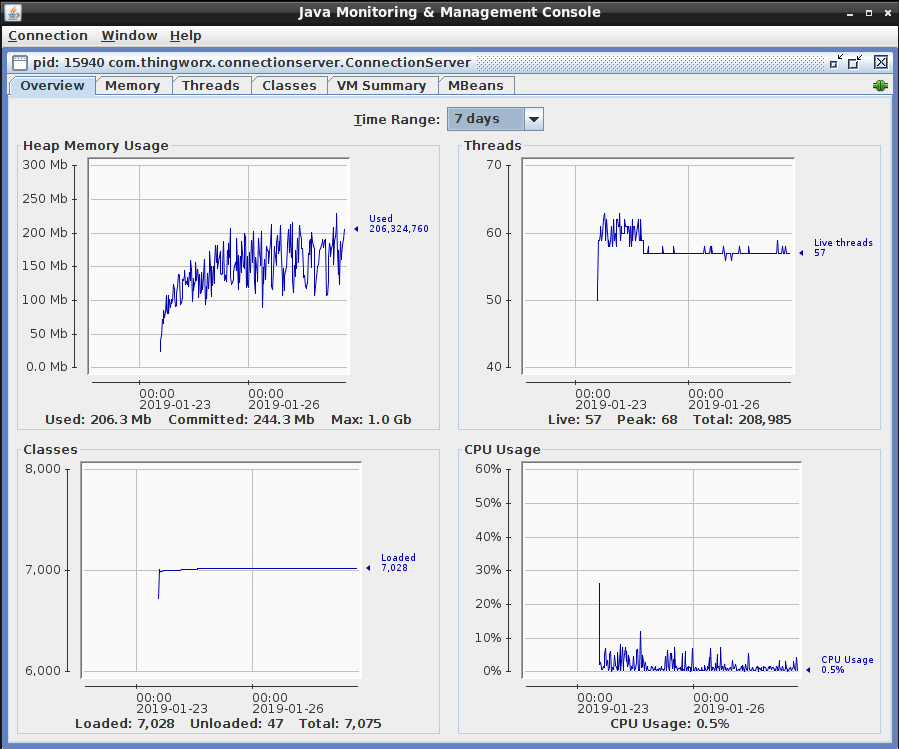

3) Restarted the connector.
Threads are now of normal value[50-65]. [during problems increased over 5000 threads].
Here below the proof of normal functionality of the thingworx connector.
