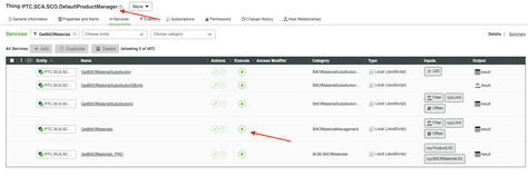

SebB
(To:aman.somgade)
Can you please try executing the "GetBillOfMaterials" service on the PTC.SCA.SCO.DefaultProductManager thing, to double check if the BOM was created successfully.

aman.somgade
(To:SebB)
I am getting no data.
I am still puzzled then why the importBOM service shows success message.
SebB
(To:aman.somgade)
Check the PTC.FSU.CORE.Process.ProcessQueue_TM timer thing and make sure you have the TriggerUpdateQueueConfiguration_PRC, TriggerUpdateQueueNotification_PRC & TriggerUpdateQueueEventBased_PRC subscription enabled.
How the endpoint work is, when you execute an endpoint service for Work Order or BOM import, the service adds the request to a queue and the timer processes the queue every 60 seconds. The result of the endpoint service only indicates that the validation and adding the request to the queue was successful.
