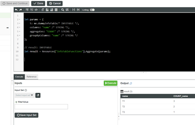

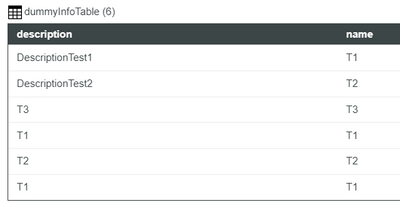

Hi @Aditya1702
You can use the Aggregate Function to get a count of values
let params = {
    t: me.dummyInfoTable/* INFOTABLE */,
    columns: "name" /* STRING */,
    aggregates: "COUNT" /* STRING */,
    groupByColumns: "name" /* STRING */
// result: INFOTABLE
let result = Resources["InfoTableFunctions"].Aggregate(params);
Input:
Output :
/VR
Aditya1702
(To:Velkumar)
Hi @Velkumar ,
What to add in place of dummyInfotable since I don't have any infotable I get infotable as an output of QueryPropertyHistory Service.
Can you please elaborate a bit more since, I am new to ThingWorx.
Thanks in Advance.
Aditya Gupta
Hi @Aditya1702
Replace me.dummyInfoTable with an output of QueryPropertyHistory service
var data = me.QueryPropertyHistory({
    maxItems: undefined /* NUMBER {"defaultValue":500} */,
    startDate: undefined /* DATETIME */,
    endDate: undefined /* DATETIME */,
    oldestFirst: undefined /* BOOLEAN */,
    fillOption: undefined /* STRING {"defaultValue":"Previous"} */,
    query: undefined /* QUERY */
let params = {
    t: data /* INFOTABLE */,
    columns: "FIELDNAME_TO_COUNT" /* STRING */,
    groupByColumns: "FIELDNAME_TO_COUNT" /* STRING */
/VR
Aditya1702
(To:Velkumar)
Hi @Velkumar ,
Thank you it did worked!!!
