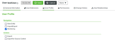

  1. For each user you need to set the Composer rights properly – what he sees from the Composer interface:
VladimirRosu_0-1740406950781.png      2. Create a user group that contains all these users. Let’s name it GuestUsers

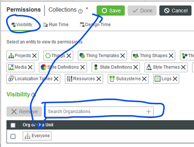

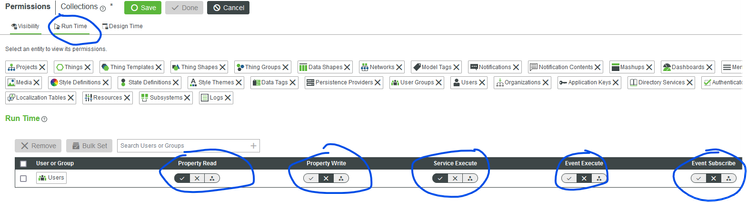

      4. In the Permissions, Collections section, you can select all Collection types (or the ones you need – option A above) and to the following
             a. Set Visibility for all entity types, at once for the GuestOrganization. This will allow users to see the entity names in Composer (nothing more).

            c. ONLY IF NEEDED - Set Runtime Permissions for all entity types, at once for the GuestUsers group. This will allow users to see also property values – and execute any service from the entity. We need the ServiceExecute just because the Composer when loading an entity in Composer it uses a Service to load all the values – does not read them directly.
