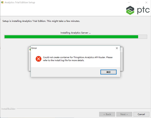

Can not create container for Thingworx Analytics API Router.
CCi_9

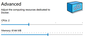

Hello
I have allocate 6G RAM to the Docker daemon and share the driver C, but it occurs problem still
undefined
undefinedundefined
int the attachments is my install logs file
How to fix this?
Thanks and Regards,
CCi_9
CCi_9
(To:cmorfin)
I had knowed what happen to it, I shuold close the firewall when I install it, and I should  close and restart the docker after setting up.

cmorfin
(To:CCi_9)
Hi
Could you indicate:
- what is the version of docker you are using ?
- what is the version of ThingWorx Analytics Trial edition you are using ... just give us the exact complete name of the installer exe file you execute.
- what OS is this ?
Thank you
Christophe
CCi_9
(To:cmorfin)
I'm sorry to reply to you so late.
- the docker version is 17.09.0-ce-win32 (downloaded from the official website)
-the version of  ThingWorx Analytics Trial edition is AnalyticsTrialEdition-8.2.0-r3-windows-installer.
-OS is win10
Thanks a lot.

cmorfin
(To:CCi_9)
Hi
thank you for this.
Could you also send the set.txt file created by the following command executed in a Command Prompt
set > set.txt
Thank you
Christophe

cmorfin
(To:CCi_9)
Hi
Could you please upload all the install log file, not just the APIRouter one ?
Christophe
CCi_9
(To:cmorfin)
