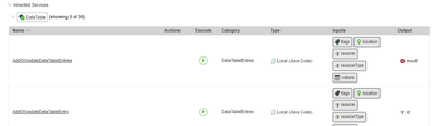

As Shown in the below video there is a service known as AddOrUpdateDataTableEntry
https://www.youtube.com/watch?v=FISQHoNV6qo
which I cannot find in the ThingWorx while adding an Service.

Hi @SP_9715784
Thank you for opening this post at community. I am curious which Thing Template you have inherited in this thing where you are trying to execute this service.
Try to use data table thing template as base template. I can see these services, check below screenshots.
Mohit
