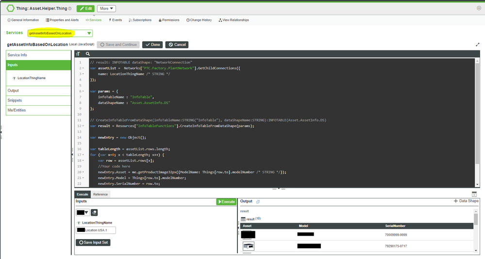

For some reason, I cannot display images in a grid widget.
My service displays the images in the output window when I run it in the composer; however, when bound to a adv grid widget in a mashup, the image column does not display the images.
The data type I'm using is IMAGE.
I followed the steps in the instructions below, but the grid is not displaying the images.
https://www.ptc.com/en/support/article/CS237433
This is my service output.  It displays the images.  This service is called within the other serviced that is called in the mashup.
This is the composer view of the mashup.
