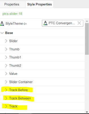

I am trying to change colour of the slider (progress bar) but i cannot find any documentation regarding it. I am using thingworx 9.1 can some one share thoughts as to where is the configuration option.

Have you checked the style properties of slider widget? You should be able to change the color from there.

@SO_9699370
Use the properties shown in below screenshot,

Thanks for the input, but the issue was solved by changing the style definition as it takes the slider progress colour from Style definition so we updated it and saw the change.
