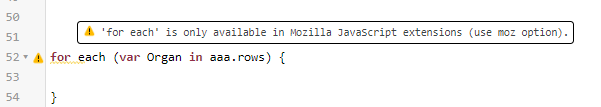

Code inspector warning with "for each"
iguerra
I have this warning when I use "for each" statement
An old thread related to TW 8.3 was telling it will be fixed with future release, I have TW 8.5.6 but warning is still present.
Can this be fixed ?

Just a loop, iterating infotable data (the sample I wrote is just to show the warn message, no code in the loop)
For-each works very well, it has no problems, code inspector  just shows the warning on the syntax that is instead correct. IMHO code inspector shows a wrong warning.
I know I can use a classic for loop with an index, but for-each is easier/beautiful/clean because doesn't need use row_length, an index variable, and also an object variable to point easily to the row data (instead of always write infot.rows[index]).
I am afraid the warning is legit. I am running Thingworx 8.4.4 on Chrome 85.0.4183.121. For each produces a warning in design time and is completely ignored in runtime. No exception or anything, just ignored.

With for-each I need to use infotable.rows, like
for each (var entry in entries.rows) {
differently it will loop just one time with the whole (and single) infotable object.
instead specifiying .rows it will loop all records (it's an array).
try ...
Absolutely makes sense. Tested immediately and had success. Thank you.
