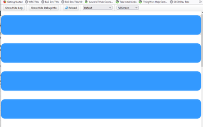

I'm trying to put some vertical space between rows in a collection widget when it is in Table view.  There is a RowSpacing property but it only seems to apply to the Flow view. I've been playing around with the CSS but I can't seem to get anything to work.  Any thoughts?
I have a workaround that almost gets me there (making the row a bit taller and put in a container that is the same color as the background of the main mashup), but then the border radius doesn't look right.

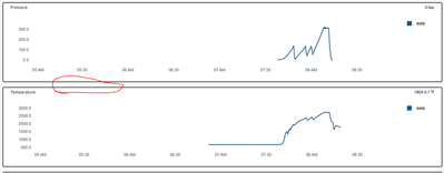

My apologies for not being clear.  I'm talking about the spacing between rows on a collection widget that is set to "Table" mode.  See image below (circled portion):

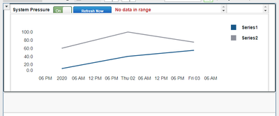

Right now I am "faking" that space in by putting an extra container under the time-series chart :
However, I'd rather set the spacing via mashup parameter or css.  Right now, when I want to select one of the rows in the collection, the chart and the space below are highlighted.

@GabrielB ,
Thanks for the solution!  We also have a requirement that the corners of each collection tile need to be rounded.  It appears that your workaround still shows the rounded corners on the right-hand side of the screen!
