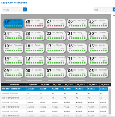

Hi guys,
In Thingworx Version "ThingWorx 8.4.2-b2151"
I'm using Collection widget to make a calendar.
I have a datatable with "date" column, column type is "DateTime".
When use collection widget, i set the sort column to date column, I have a service to load data from datatable by Month(each time it only load 28-31 rows from datatable base on user's choice of month).
Collection widget display correctly on default load, date is in order from 1 to the end of month(Service triggered when mashup loaded), but when user select different month, date order is mess up, no longer sort by date column, even user go back to the default loaded month, date order still mess up.

Thank you for reply! Yes it did bind with data, I attached screen shots. I thing I forgot to say is it was working on different server, but it broke after I moved it

and I found some funny errors as below:
1. This is the service bind to collection:
2.This is same service bind to a grid(to see selected data)

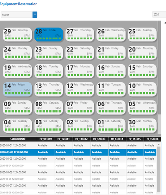

3. In default load, everything seems ok     
4. After I change Month(changed a parameter input for service "GetCalendarByMonthAndYear"). Collection Display wrong date but Grid is selecting the right date 03/02
5. Same thing happened even I changed the Zoom in size of my browser.........
Any possible my CollectionWidget is broken? I'm using Chrome in different machine and get same result.

I did try enable and disable the sort in collection widget. Neither works. Run service again, change screen zoom in level or change month/year/device will make the display go off.....
I'm begin to wonder if my collection widget is broken and should I reinstall it...not that I know how to reinstall...
