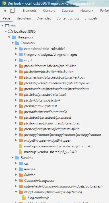

Hi!  In the "Create Mashup Widget Extension"- Guide it says "You can find examples of widgets in the Tomcat_Installation_Folder/webapps/Thingworx/Common/thingworx/widgets directory." (Source: https://developer.thingworx.com/en/resources/guides/create-mashup-widget-extension/mashup-widget-coding )
But im my ThingWorx 8.4 trial installation this directory and its subdirectories contain no single *.js file, but only image files. I guess something has changed since the guide was written. Does anybody have hints where the JS-files for the standard widgets could be obtained? I searched for *.js files in Tomcat_Installation_Folder/webapps/Thingworx and browsed through the results, but nothing looked like the widget sources to me.
Best answer by Helge_Kosuch
In Chrome Dev Tools, ThingWorx 8.4:
Or, hidden in a much longer files:
"C:\Program Files (x86)\ThingWorxH2Trial-8.4.0-SNAPSHOT\tomcat\apache-tomcat-8.5.23\webapps\Thingworx\Builder\mashup-common-widgets-builder.js"
"C:\Program Files (x86)\ThingWorxH2Trial-8.4.0-SNAPSHOT\tomcat\apache-tomcat-8.5.23\webapps\Thingworx\Runtime\mashup-common-widgets-runtime.js"

Hi, the guide needs to be updated. In the later ThingWorx versions, the extensibility is revamped with widgets now being web-components.

Now I can answer my own question: You can still find all the sources in http://localhost:8080/Thingworx/Runtime/button/Common/thingworx/widgets/
