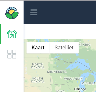

Hi all,
I want to build a menu. On each item in the menu I want to use a negative icon and a normal icon. I have seen this once in one of the ThingWorx demo's. They look like this:
How did they to it? Is there an easy way? Or did they use CSS? If CSS, can someone help me how this CSS would look like?

Hi @jasperlg.
I was provided with the attached exports which should give you some idea of how to implement the design you are looking for.

Hi @jasperlg.
Could you provide a link to the demo or some information to help us identify who created it?  We can then reach out to try to identify the method used for addressing your needs.

Hi @slangley ,
I found this in the  Smart Farm demo from PTC.

Hi @jasperlg.
If this response provides the answers you needed, please mark it as the Accepted Solution.
