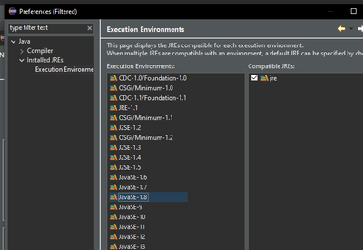

Now for the JRE I am not so sure.
It says in the guide to use JRE 1.8. But I am not sure if I am actually using it.
If I use the "Use default JRE 'jre' and worspace" option:
And I have configured it like this:
Is it using JRE 1.8?

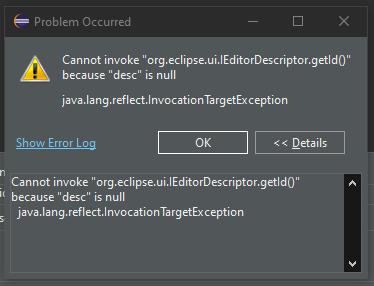

If I then create the project using these settings and try to add a new widget to the project:
I get this error:

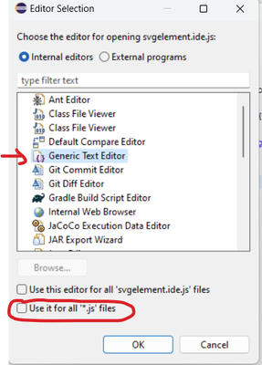

When adding a new widget, the extension will create automatically a bunch of JS and CSS files and will try to open the JS file in the current Eclipse editor for JS/CSS files.
However, as far as I have seen, a default editor for JS files is not set by default (I think Eclipse will try to use Window's editor for JS files and usually there's not one set; this is called the "System editor"), and this hidden issue will trigger that error message.
Right click on a JS file, Open With, Other and select your editor of choice.

Ah I see, that makes sense. I did notice that it wasn't possible to open the .js (or .css?) files in eclipse.
In the end I just opened them directly from the folder in a different tool.
My guess is that even if I modify the files and save them in the original folder from a different program it will still work.
