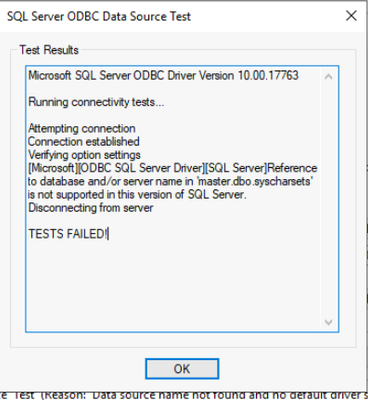

When I Have Connected the Azure SQL Server in the Data logger (DSN) I got the following Error:
How to solve this ?

Hi There,
I have found out the cause for this issue, the reason behind this was the SQL Driver for ODBC was of the old version. When I have downloaded and installed the Latest SQL Driver for ODBC then it worked and connected successfully.
We can also connect to other Servers like Postgres by downloading and installing the particular latest driver for ODBC.

Hi @pshashipreetham
Here's a link to the Help Center regarding the jdbc connector extension--I noticed you're trying to use odbc.  Please let us know if you continue to have problems after reviewing the article, and if so, please provide the version of ThingWorx you're running and further details of the issue.
