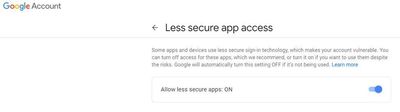

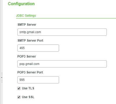

Facing issue with email send using Gmail SMTP settings. same i had used earlier it was working fine but sudden it is failing to send. giving error, unable to send error email for logged incident. please see below snap for reference.

Two step verification is off already.
Hi @rjanardan
I have enabled less secure app , i have mentioned error in topic heading from application log and using mail extension 3.6 but i don't know about telnet.

1. Please go in the Logging subsystem, enable stack tracing, try to send again your mail.
After it fails, go in the ThingWorx storage folder, in logs, and check the last entry in the ErrorLog.log file (look for the exact file name corresponding to today).
That line should correspond to your error. Tell us the stack trace, exactly how it is there.
2. What was the message after running telnet?
