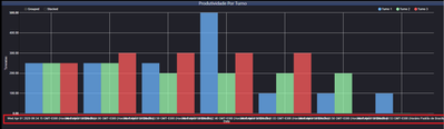

hello dear friends,
would like a help, can you tell me if it is possible to remove the caption that is in the red box below?
since already thank you.

@Marcus_Konflanz ,
Have you reviewed the properties for the Chart Widget?
  • ShowXAxisLabels
  • XAxisTitle
If this does not address you issue, provide more information on the chart? What version of ThingWorx, What widget, and properties settings.

Hello @PEHOWE  ,
thank you for your availability,
your suggestions did not solve my problem with that information piled up ...
I'm using TWX 8.5 and Widget BarChart v3.0.3

@Marcus_Konflanz ,
Thanks for the additional information. With ThingWorx 8.5 you should not have been required to load the Market Place Widget , Custom Chart Widgets v3.0.3. The item is part of the base ThingWorx product.

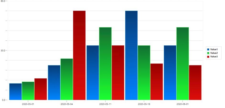

I created a simple chart.
This is using the Label Chart Widget. Can you provide more information on your data and the widget properties which you are using and I will see if I can recreate the issue and identify a solution.
Peter
