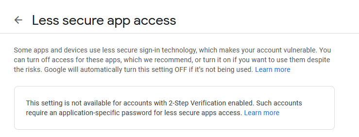

I want to correct something for point 4.
If your Google account has Two Factor Authentication enabled (2FA), you can not enable or disable that setting.
Instead, you will need to create Application Specific Passwords  and use those as your password (a common behavior with almost all the third party systems that use 2FA today, GitHub, Azure DevOps etc).

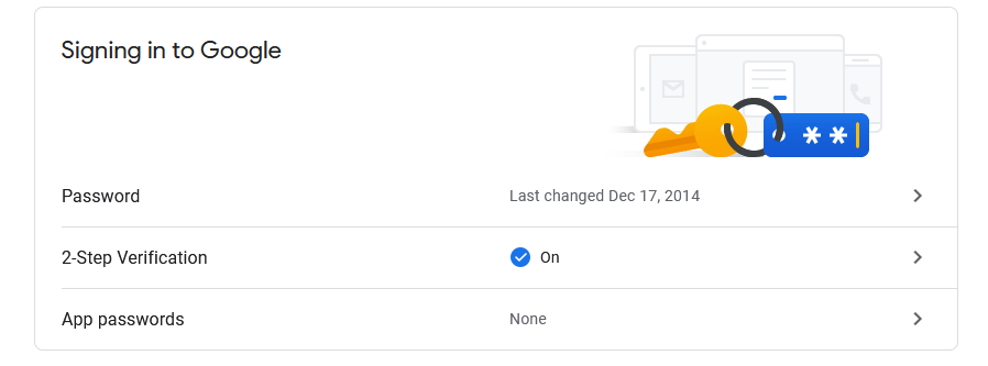

And yes, I do know that I did not change my password from 2014.
Two step verification is off already.
