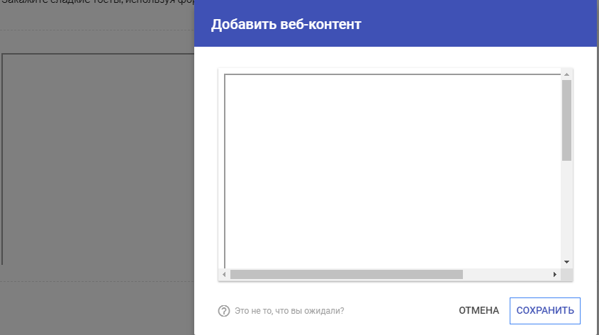

I have a mashup link: https://academic-educatorsextension.portal.ptc.io/Thingworx/Mashups/sw_make_panel_MrPark?appKey=f254750f-a512-4150-ac0b-5e3fd6b3c1fa&x-thingworx-session=true
I'm trying embed this page with this code:
<iframe src="https://academic-educatorsextension.portal.ptc.io/Thingworx/Mashups/sw_make_panel_MrPark?appKey=f254750f-a512-4150-ac0b-5e3fd6b3c1fa&x-thingworx-session=true" width="650" height="600" scrolling="auto"> </iframe>
but I get empty form:
What's your ThingWorx log saying and when you access this page, what's your F12 composer console saying?
It could be a security issue related to the origin.
I'm not sure if you have access to configuring the Academic instances - but maybe these articles explains more around the topic:
https://www.ptc.com/en/support/article?n=CS181456
Cheers,
Michael

Try to inspect the page headers that come from the ThingWorx server.
It might be because you have the following headers sent: ClickjackFilterDeny and ClickjackFilterSameOrigin.
If this is the case, check the server side configuration here: http://support.ptc.com/help/thingworx_hc/thingworx_8_hc/en/#page/ThingWorx%2FHelp%2FSecurity%2FAllowingEmbeddedMashupsiniFrames.html%23
Emil
