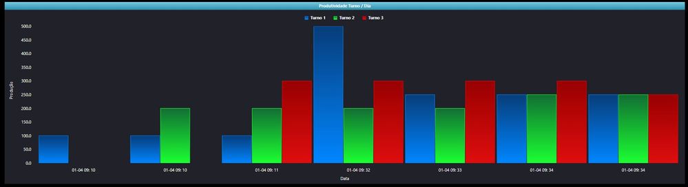

Hello everyone,
How do I enable gridlines on the x and y axes? Am I not able to enable this?

Which version of ThingWorx are you running?  Which chart did you use for creating the chart from your image?
Under 8.5.5, we do see gridlines for the Y axis on the label chart.  There is an open issue for the X axis.  At this point, we don't have a target date for the fix.
However, if you download and import the Custom Chart Widget extension from the Marketplace, it should resolve your issue.  This widget includes a bar chart widget that has hard-coded grid lines.

Hi @slangley
Thank you for answer.
I used the another version and it worked well.
