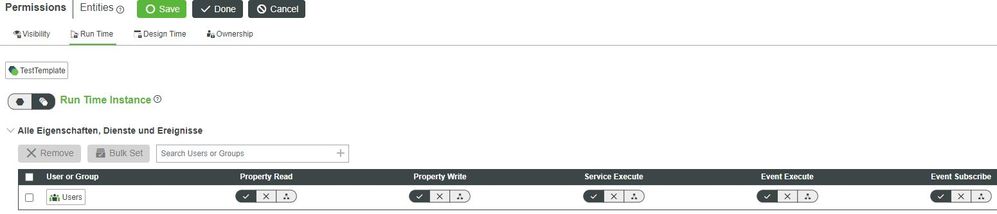

we are facing an issue when adding a service on a Thing Template.

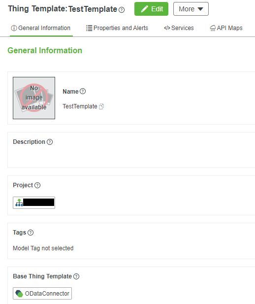

We created a Thing Template which is based on the ODataConnector Thing. A new Thing should use the template by calling its services. So the inherited chain looks like this:
Thing Test-TestTemplate-ODataConnector

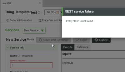

But when trying to add a new service to the TestTemplate and by adding a route, the following errors pops up:

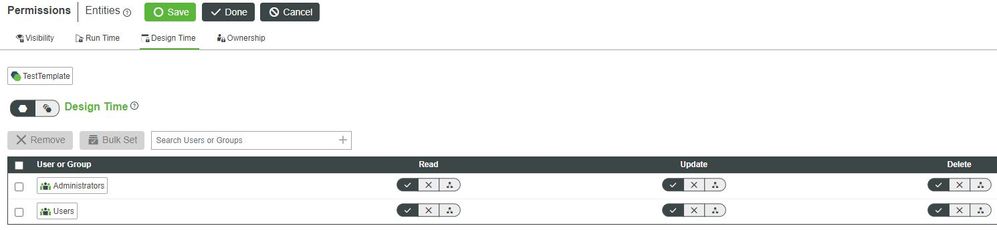

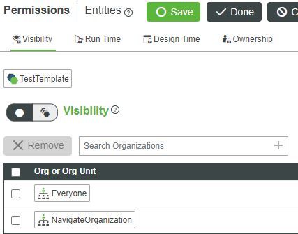

We did a lot of research and found some similiar issues, which were all related to missing access rights.
So we assigned all groups that were suggested but still no luck:
TestTemplate uses ODataConnectorTestTemplate uses ODataConnector
TestTemplate Permissions VisibilityTestTemplate Permissions Visibility
TestTemplate Permissions Visibility InstanceTestTemplate Permissions Visibility Instance
TestTemplate Permissions RuntimeTestTemplate Permissions Runtime
TestTemplate Permissions Runtime InstanceTestTemplate Permissions Runtime Instance
TestTemplate Permissions DesigntimeTestTemplate Permissions Designtime
TestTemplate Permissions Designtime InstanceTestTemplate Permissions Designtime Instance
Does anyone have an idea, how to fix that error?

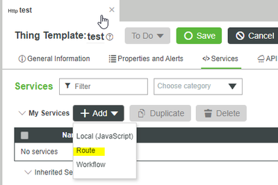

You may want to describe it simpler (basically you stated it with a lot of additional infos which may be confusing):
1. Create a new ThingTemplate with baseTemplate ODataConnector
2. Save the ThingTemplate
3. Now -in edit mode- add a new service and select "Route"
4. Error is shown

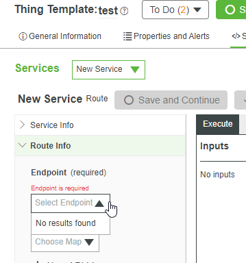

I assume the error may be because no endpoints are defined:
But I did not look into it deeper - just tried to reproduce. Maybe someone can help from here who knows the ODataConnector
Thanks for your investigations and the clarification. But in our situation, there are endpoints on the related thing available.
as a side note: when you think you have a permission issue just try it with Administrator user. If the issue persists you do not have a permission issue.
We are already using a Administrator user. I was just trying to point out that usally permission issues were the cause for others who had similiar issues.
