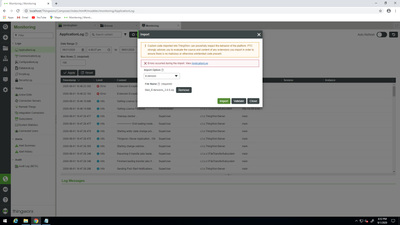

i am using ThingWorx 9.0, when I try to import any extension, it gives me error in the validation and importing

Hello @Ahmed_1,
ThingWorx Mail Extension 3.6.0 is not supported in ThingWorx 9.0. Refer and login to PTC eSupport Website. Expand Release 9.0 > ThingWorx Mail Extension > Most Recent Datecode to download version 4.0.0. This is the supported version for ThingWorx 9.0.
Emmanuel
Ahmed_1
(To:emscur)
Thank you, i have solved the problem, the problem in the platform-settings.json
