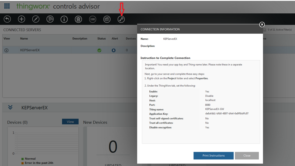

I am trying to connect TW connectivity(kepserver) with another machine that runs the composer on the same network.
I can even run composer from the machine that runs kepserver.
I Have correctly setup application key etc.
But I get the following error in the kepserver log console.

5/7/18 4:15:03 PM Error ThingWorx Native Interface Connection to ThingWorx failed for an unknown reason. | Platform 172.22.154.167:8080/Thingworx/WS, error: -1.

5/7/18 4:19:20 PM Debug ThingWorx Diagnostics [ERROR] 2018-05-07 10:49:19,667 twMessaging::handleMessage: Response ID 3 has code 160: Binding failed, see server log for more information
5/7/18 4:19:20 PM Debug ThingWorx Diagnostics [ERROR] 2018-05-07 10:49:19,667 twApi_Connect: Max number of connect retries: 1, has been reached
5/7/18 4:19:20 PM Error ThingWorx Native Interface Connection to ThingWorx failed. | Platform 172.22.154.167:8080/Thingworx/WS, error: unknown error.
5/7/18 4:19:20 PM Debug ThingWorx Diagnostics [WARN] 2018-05-07 10:49:19,910 msgHandlerOnClose: WEBSOCKET CLOSED
5/7/18 4:19:21 PM Debug ThingWorx Diagnostics [ERROR] 2018-05-07 10:49:21,477 twMessaging::handleMessage: Response ID 6 has code 160: Binding failed, see server log for more information
I am unable to find root cause of this issue, if anyone has faced something similar , please drop a hint.

Hi @mtyago,
Can you please validate if the host name, port and other configuration are correct?
You can validate the settings needed for KEPServerEX by going to Controls Advisor in Manufacturing Apps, selecting the connection, then clicking the key (see screenshot).  Then you can copy/paste to the KEPServerEX config for ThingWorx.
Please let us know if you still have issues once you have validated these settings.
If my response has answered your question, please mark as Accepted Solution, for the benefit of others who may have the same question.

Hi Himanshu,
                           In our case, we were able to solve the issue by changing proxy settings.
Thanks for the reply.
