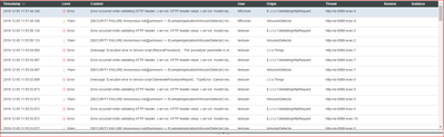

Hello, I noticed that when I went through our demo for the Lock out tag out sequence that the reports are not showing up.
Please see the snip below displaying the error message from the report log.
Another thing I noticed was when we go through the checklist and select “I confirm all these steps are complete” in the demo I believe the window would disappear, but now we have to click on something else in order for the display to clear.
Please Advise
-Matt

Hi Matt,
I had a similar issue, to resolve this I changed the validation.properties file in ThingworxStorage\esapi
.To see quickly if this is working for you, can you try the attached file ?

Hi Matt,

You dont have to import that file from the composer.
When you installed Thingworx, you must have created 3 folders (mostly in your PC's OS (C:\) drive) namely 'ThingworxPlatform', 'ThingworxStrorage' and 'ThingworxBackupStorage'.
So the validation properties file has to be kept in '..\ThingworxStorage\esapi' path. For example in my case the path is 'C:\ThingworxStorage\esapi'. When you will browse the folder location you will find an already existing validation.properties file, so you just have to replace it with what you have downloaded from the post.
After that remember to restart your Apache Tomcat service, and then possibly you will not see the error anymore.
Hope it helps!
