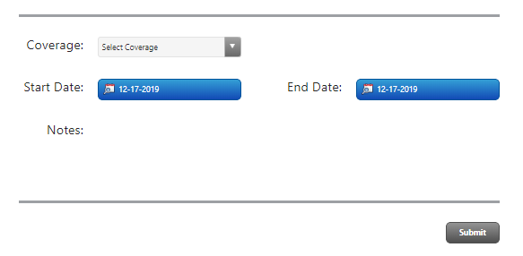

Text Area widget (BETA) does not display when the mashup is viewed.  I am on thingworx 8.4.5.  Did I miss something in the widget configuration?

Willie
(To:Radu)
Please see the attached.  I don't need for it to fill the entire space.  I just need to be able to see the borders so that the users know that there is a text area.  There is a text area next to "Notes:" but it looks like there is nothing there since the borders are not visible.

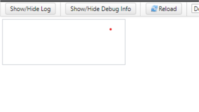

Radu
(To:Willie)
I see that the text area is enclosed by some borders for me, at least. See this screenshot below:

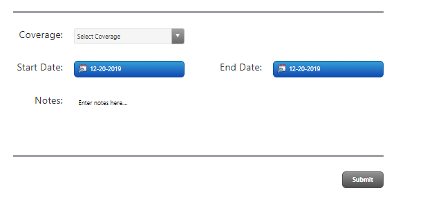

Rajesh_Sayana
(To:Willie)
One more thing you could try is add a text such as "Please enter text here" in the Hint Text property of the Text Area widget. This would display a hint text on the mash up when the page is loaded making the user know that there is a text area field. Try this out and see if that helps.
That kind of helps but it's still not the solution I'm looking for.  Is this a known bug for this widget?  Not sure why it works for some people and not for others.
I tried adding "hint text" but it doesn't look right.
