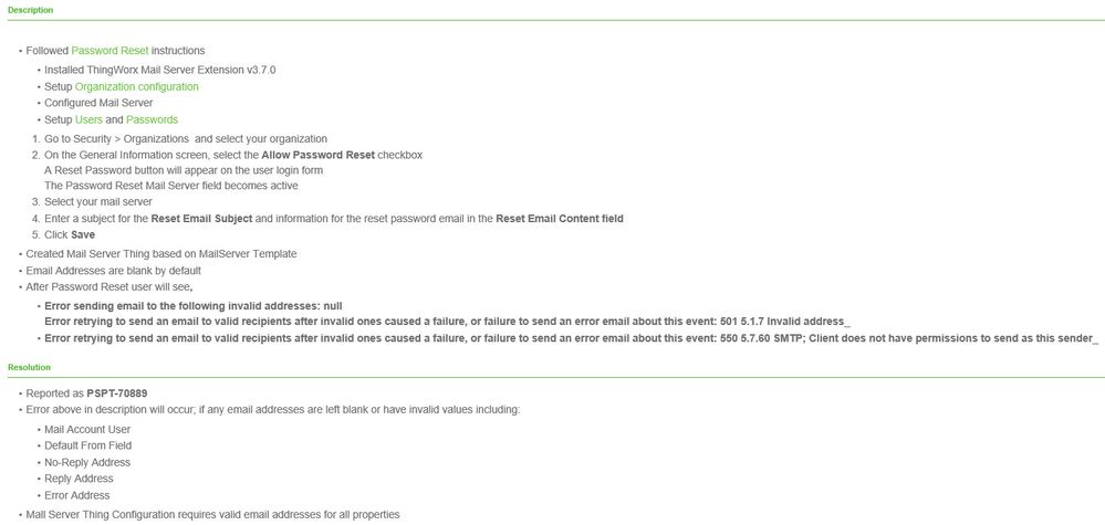

Please check if article CS341590  is useful to this issue.

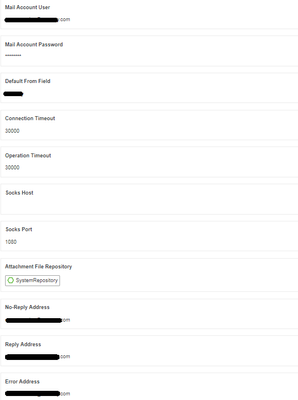

Normally we create a thing that extends MailServer, so do you check these configurations(Mail Account User,Default From Field,No-Reply Address,Reply Address,Error Address) of this thing instead of the MailServer template?

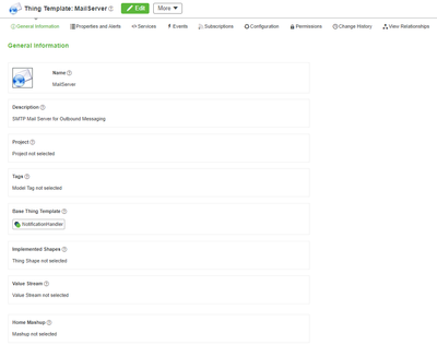

There is this Mail Server Thing template

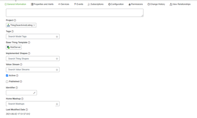

I extended it using myEmailServer:
Then in organization
I added myEmailServer
Still not able to solve the issue

Yes I double checked them, I also tested the send email function to test functionality and is working
