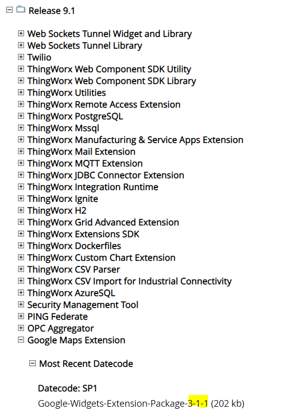

Hi All,
I ma getting a error when I am importing google map widget in Thingworx 9.1. Can you please have a look and let me know why is the issue coming.
Below is the error message -
ERROR [widget] "CustomCSS" widget type is missing required member widgetProperties()

I was able to import the google widget extension you provided on my Thingworx 9.1 instance. Please check if "ExtensionPackageImportPolicy" tag is present in your platform-settings.json file or not.

As per the logs it seems that the extension is already imported. Following is the entry in the logs 'Extension GoogleWidgets_ExtensionPackage:3.1.1 skipped because it is already installed'
Can you check from composer if there is a GoogleWidget extension?

Hi @SachinSharma,
Yup this time the map is present in the list of widget, but when I place the widget in the mashup, it says google maps are not available.

Hello @SO_9699370
It seems you have not configured Google API key which is required here.
Please refer the following article for the same
https://www.ptc.com/en/support/article/CS188314
