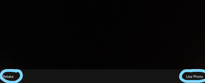

Hello everyone,
I want to use the file upload widget on a tablet. Specifically, users need to upload MULTIPLE images via the "Take Photo or Video" option that opens up the camera app.
But here two issues arise:
1. I have enabled "MultiFilesSelect". Uploading multiple picture via Files and Photo Library works. But when selecting "Take Photo or Video", you can only take one picture.
2. All images uploaded via "Take Photo or Video" are named "image.jpg". So even if I were to put multiple upload widgets, I would have to invoke a service to rename the files multiple times?
Can anyone think of a solution? Putting 5 upload widgets in the mashup where each time the user has to also press "upload" is super user-unfriendly.

Hi @HD_10225728,
If MultiFilesSelect works with Photo Library, couldn't users take multiple photos using camera not using this file upload widget and then go to Photo Library to select multiple images taken outside of the mashup?

Possible, yes, but bad user-experience in my opinion. Also the tablet has to be used by multiple people and multiple pictures need to be taken, this would spam the Photo Library of the tablet.

I see. Then I'm afraid that will require an enhancement to make Take Photo or Video feature on Tablet work better in the context of MultiFilesSelect checked.
Please post your enhancement request and use case in below site.
https://community.ptc.com/t5/ThingWorx-Ideas/idb-p/thingworxideas
