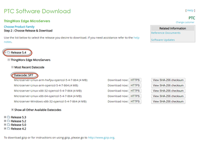

Please find latest version of EMS  on PTC Support Portal:
A way to solve the issue is to add a sleep in the service that is waiting for the modification of file to be finished, only after that the file should be transferred.

What version of EMS are you using? It is possible to be a defect corrected in the latest version of EMS.

Latest version is 5.4.7, but if you are saying the file is modified while it is transferred, then it is normal that checksum to be modified also.
An approach will be to  transfer file after modification is complete or somehow avoid file modification while in transit.

Where can I find the latest version 5.4.7.
